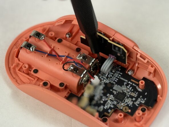

    1. Microsoft Bluetooth Ergonomic Mouse Side Buttons Replacement, Thumb/Side Buttons: step 5, image 1 of 3 Microsoft Bluetooth Ergonomic Mouse Side Buttons Replacement, Thumb/Side Buttons: step 5, image 2 of 3 Microsoft Bluetooth Ergonomic Mouse Side Buttons Replacement, Thumb/Side Buttons: step 5, image 3 of 3
      • Remove the three 4.1 mm Phillips #00 screws securing the motherboard.
      • The motherboard should now be loose while remaining connected by wires.

    2. Microsoft Bluetooth Ergonomic Mouse Side Buttons Replacement: step 6, image 1 of 2 Microsoft Bluetooth Ergonomic Mouse Side Buttons Replacement: step 6, image 2 of 2
      • Remove the two 7.1 mm Phillips screws securing the side button board.
      • The side button board remains connected to the main motherboard by soldered wires. Do not fully remove the board.

    3. Microsoft Bluetooth Ergonomic Mouse Side Buttons Replacement: step 7, image 1 of 2 Microsoft Bluetooth Ergonomic Mouse Side Buttons Replacement: step 7, image 2 of 2
      • Lift the main motherboard and side button board carefully to access the plastic side button components.
      • Avoid pulling or straining the wires connecting the boards.
      • The plastic side button components should now be accessible.
