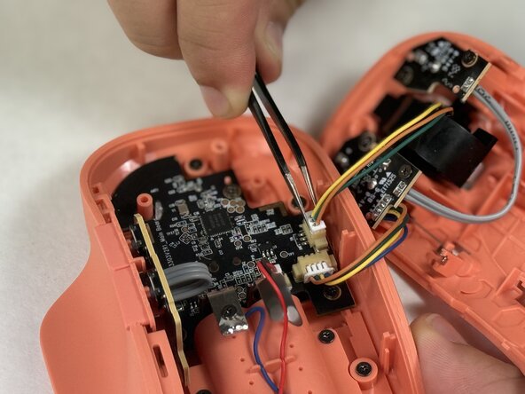

  5. Microsoft Bluetooth Ergonomic Mouse Scroll Wheel Replacement, Scroll Wheel: step 5, image 1 of 3 Microsoft Bluetooth Ergonomic Mouse Scroll Wheel Replacement, Scroll Wheel: step 5, image 2 of 3 Microsoft Bluetooth Ergonomic Mouse Scroll Wheel Replacement, Scroll Wheel: step 5, image 3 of 3
    • Identify the two white connectors attached to the scroll wheel assembly.
    • Disconnect both connectors from their sockets using tweezers.
    • Pull from the plastic connector housing rather than the wires.
    • Pulling on the wires may permanently damage the connectors.
