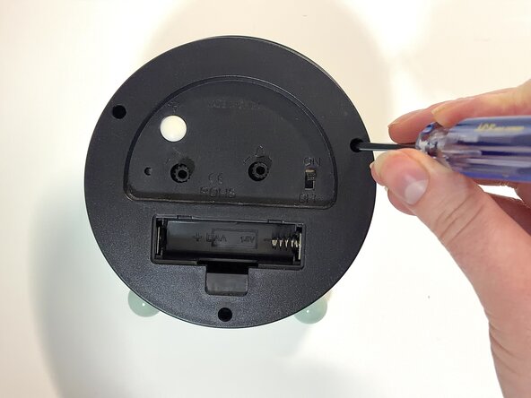

Mensent Quartz Electronic Analog Clock Alarm Trigger Repair
  1. Mensent Quartz Electronic Analog Clock Alarm Trigger Repair, Mensent Quartz Electronic Analog Clock Alarm Trigger Repair: step 1, image 1 of 3 Mensent Quartz Electronic Analog Clock Alarm Trigger Repair, Mensent Quartz Electronic Analog Clock Alarm Trigger Repair: step 1, image 2 of 3 Mensent Quartz Electronic Analog Clock Alarm Trigger Repair, Mensent Quartz Electronic Analog Clock Alarm Trigger Repair: step 1, image 3 of 3
    • Lay the clock facedown and remove the battery.
    • Unscrew the back cover.
