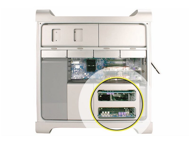

    1. Memory (FB-DIMMs) and Memory Riser Cards (Early 2008) Replacement, Memory (FB-DIMMs) and Memory Riser Cards (Early 2008): step 3, image 1 of 1
      • Additional pairs of 1 GB, 2 GB, or 4 GB FB-DIMMs can be installed in the open DIMM slots. Maximum memory is 32 GB.
      • DIMMs must be installed as pairs of identical size and type, from the same vendor. Use the provided illustration, like-colored DIMMs must match.
      • DIMMs for Mac Pro (Early 2008) must fit these specifications:
      • 800 MHz, DDR2, FB-DIMMS
      • 72-bit wide, 240-pin modules
      • 36 memory ICs maximum per DIMM
      • Error-correcting code (ECC)
      • Important: For proper operation of Mac Pro (Early 2008) computers, Apple recommends using only Apple-approved Mac Pro (Early 2008) FB-DIMMs

    2. Memory (FB-DIMMs) and Memory Riser Cards (Early 2008) Replacement: step 4, image 1 of 1
      • Warning: Always wait 5–10 minutes for the computer to cool down before you remove or install memory. The DIMMs may be very hot.

    3. Memory (FB-DIMMs) and Memory Riser Cards (Early 2008) Replacement: step 5, image 1 of 1
      • Holding the memory riser card by the two finger holes, pull it out of the memory cage and place the card DIMM side up on a soft, clean cloth.
