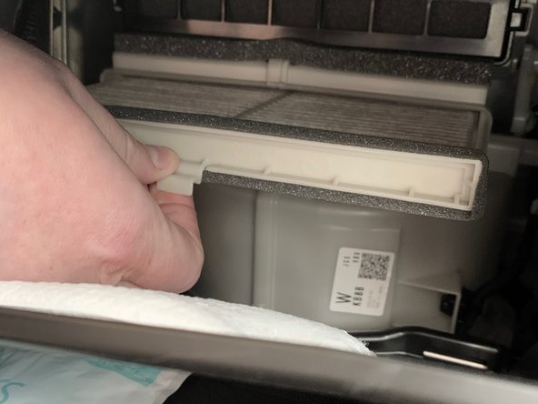

  3. Mazda CX-5 Cabin Air Filter Replacement: step 3, image 1 of 3 Mazda CX-5 Cabin Air Filter Replacement: step 3, image 2 of 3 Mazda CX-5 Cabin Air Filter Replacement: step 3, image 3 of 3
    • Locate the cabin filter with hook that is facing down.
    • Lift the hook and pull out the filter.

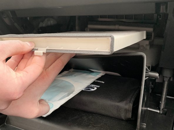

  4. Mazda CX-5 Cabin Air Filter Replacement: step 4, image 1 of 1
    • Put in the new cabin filter and place the tray back into the slot with the hook facing down.
