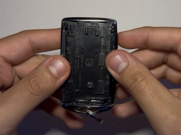

    1. Mazda CX-30 Key Fob Battery Replacement, Key Fob Battery: step 1, image 1 of 3 Mazda CX-30 Key Fob Battery Replacement, Key Fob Battery: step 1, image 2 of 3 Mazda CX-30 Key Fob Battery Replacement, Key Fob Battery: step 1, image 3 of 3
      • Slide the small black release lever at the top of the key fob downward while pulling the back cover to separate the casing.

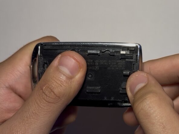

    2. Mazda CX-30 Key Fob Battery Replacement: step 2, image 1 of 3 Mazda CX-30 Key Fob Battery Replacement: step 2, image 2 of 3 Mazda CX-30 Key Fob Battery Replacement: step 2, image 3 of 3
      • Lift and remove the metal plate from the key fob.

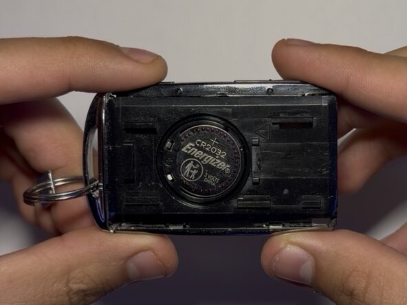

    5. Mazda CX-30 Key Fob Battery Replacement: step 5, image 1 of 3 Mazda CX-30 Key Fob Battery Replacement: step 5, image 2 of 3 Mazda CX-30 Key Fob Battery Replacement: step 5, image 3 of 3
      • Insert a plastic spudger into the gap beside the battery.
      • Gently lift the battery out of its housing.
      • Do not puncture or bend the battery, and avoid handling it with metal tools.
