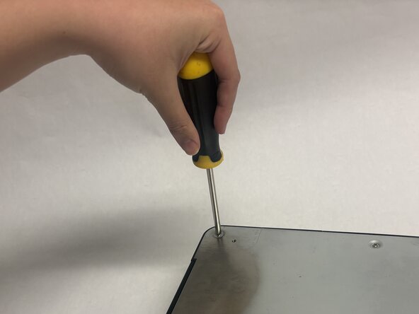

    1. Mayflash F500 PCB Replacement, PCB: step 1, image 1 of 3 Mayflash F500 PCB Replacement, PCB: step 1, image 2 of 3 Mayflash F500 PCB Replacement, PCB: step 1, image 3 of 3
      • Remove the six Phillips screws on the bottom of the controller.
