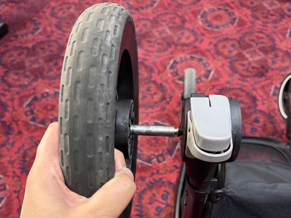

    2. Maxi-Cosi Zelia Rear Brake Hub Spring Replacement: step 2, image 1 of 3 Maxi-Cosi Zelia Rear Brake Hub Spring Replacement: step 2, image 2 of 3 Maxi-Cosi Zelia Rear Brake Hub Spring Replacement: step 2, image 3 of 3
      • Press the release button near the center of the rear wheel and pull the wheel straight off the axle.

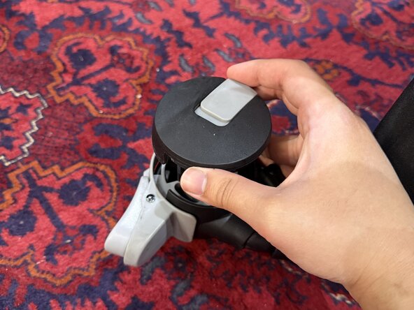

    3. Maxi-Cosi Zelia Rear Brake Hub Spring Replacement: step 3, image 1 of 2 Maxi-Cosi Zelia Rear Brake Hub Spring Replacement: step 3, image 2 of 2
      • Using a Phillips screwdriver, remove the four screws securing the circular brake hub cover. Keep the screws in a safe place so they don’t roll away.
      Ask FixBot
    4. Maxi-Cosi Zelia Rear Brake Hub Spring Replacement: step 4, image 1 of 1
      • Gently lift the brake hub cover off to reveal the internal brake mechanism. Open it slowly to avoid disturbing the internal parts.
