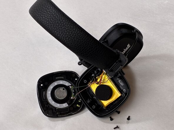

    4. Marshall Major IV Battery Replacement: step 4, image 1 of 2 Marshall Major IV Battery Replacement: step 4, image 2 of 2
      • Gently remove the driver assembly and set it beside the housing, with care not to strain the connected cables.
      Ask FixBot
    5. Marshall Major IV Battery Replacement: step 5, image 1 of 1
      • Unplug the white battery connector from the PCB.
      Ask FixBot
    6. Marshall Major IV Battery Replacement: step 6, image 1 of 1
      • Use an opening tool to gently pry up and remove the battery.
      Ask FixBot
