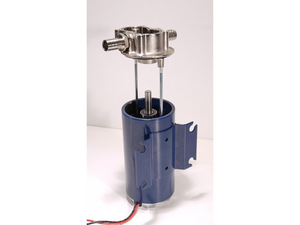

  5. Marco UP Series Electric Pump Assembly, Insert the pump head: step 7, image 1 of 3 Marco UP Series Electric Pump Assembly, Insert the pump head: step 7, image 2 of 3 Marco UP Series Electric Pump Assembly, Insert the pump head: step 7, image 3 of 3
    • Make sure that the pump's brusholder is in the correct position, like in the first picture. You should have the cables looking down on the right and the MARCO logo in the sticker on the stator that looks toward pump's head.
    • Insert the pump's head tie-rods in the holes between the magnets.
    • There's only one way to mount it right, the other is upside down! Watch the pictures.
    • Push the tie-rods down to the end of the motor: they should come out on the other side, as seen in the next steps.
    • The smaller motors have the tie-rods placed horizontally: refer to the position of the holes in the pump's head to understand the right direction to assembly them!

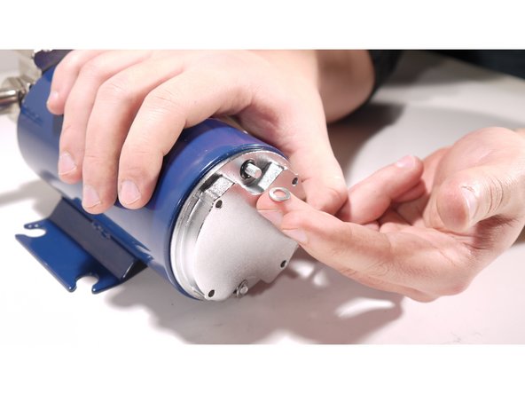

  6. Marco UP Series Electric Pump Assembly, Fix the nuts: step 8, image 1 of 3 Marco UP Series Electric Pump Assembly, Fix the nuts: step 8, image 2 of 3 Marco UP Series Electric Pump Assembly, Fix the nuts: step 8, image 3 of 3
    • First insert the o-rings.
    • Then add the washers.
    • Eventually, close slightly with the nuts.
    • Before screwing firmly the nuts, shake a little the assembly or allow a few kicks with a soft mallet on the back of the pump, to adjust the mechanical parts to each other.
    • If you can, test that the motor rotates freely by connecting it to the power supply right now. This is a useful step to do right now, because if the brushes are not correctly assembled, you'll have to disassembly the pump again e start from step 4.
    • Firmly fix the nuts, but be prepared to untighten them as needed if the pump draws too much current.

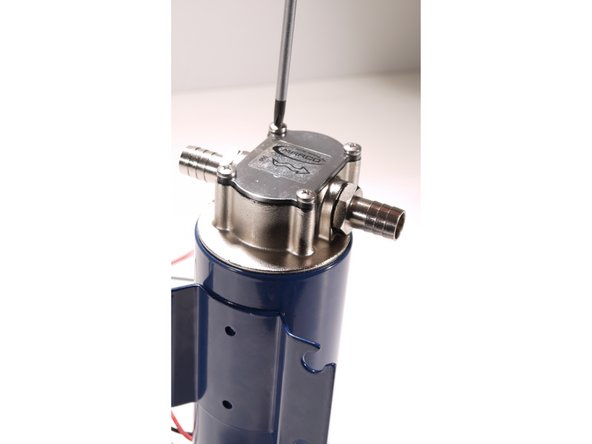

  9. Marco UP Series Electric Pump Assembly, Lock the top plate with the screws: step 12, image 1 of 3 Marco UP Series Electric Pump Assembly, Lock the top plate with the screws: step 12, image 2 of 3 Marco UP Series Electric Pump Assembly, Lock the top plate with the screws: step 12, image 3 of 3
    • Don't close them too tight, the screwdriver strength is ok!
