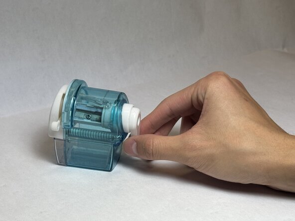

    1. Manual Pencil Sharpener Blade Replacement, Blade: step 1, image 1 of 3 Manual Pencil Sharpener Blade Replacement, Blade: step 1, image 2 of 3 Manual Pencil Sharpener Blade Replacement, Blade: step 1, image 3 of 3
      • Remove the back screw located inside the crank.

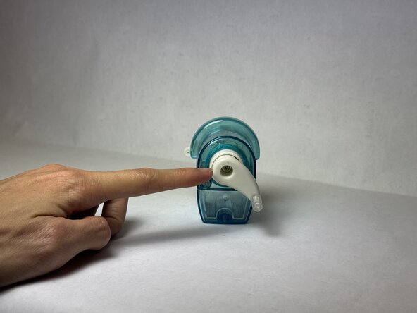

    2. Manual Pencil Sharpener Blade Replacement: step 2, image 1 of 2 Manual Pencil Sharpener Blade Replacement: step 2, image 2 of 2
      • Extract the crank from main body of the pencil sharpener.

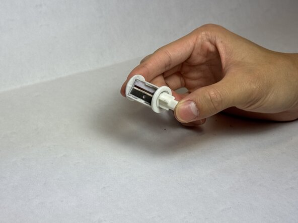

    5. Manual Pencil Sharpener Blade Replacement: step 5, image 1 of 3 Manual Pencil Sharpener Blade Replacement: step 5, image 2 of 3 Manual Pencil Sharpener Blade Replacement: step 5, image 3 of 3
      • Extract the front vice assembly.

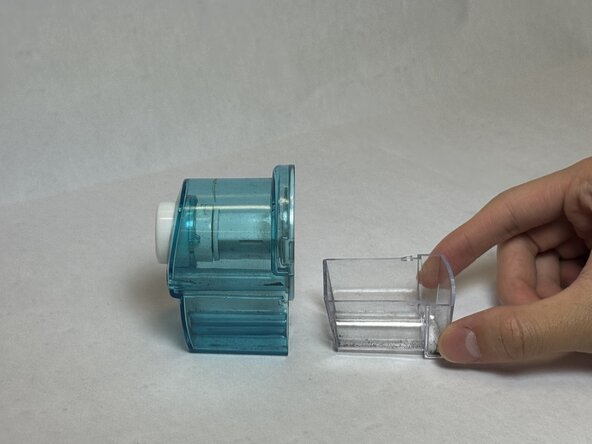

    6. Manual Pencil Sharpener Blade Replacement: step 6, image 1 of 2 Manual Pencil Sharpener Blade Replacement: step 6, image 2 of 2
      • Remove the collection tray.

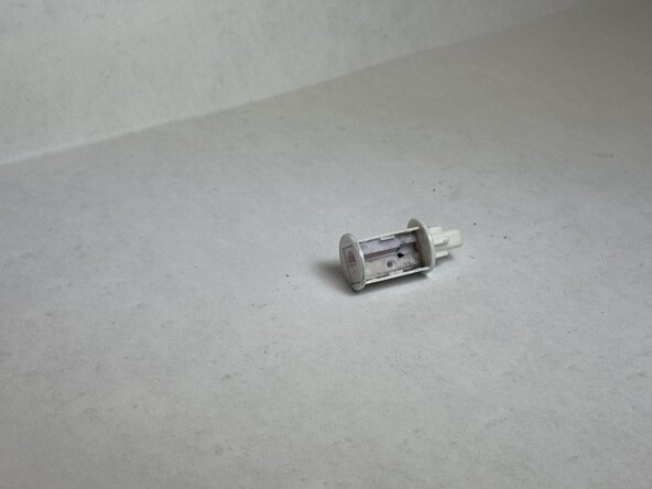

    8. Manual Pencil Sharpener Blade Replacement: step 8, image 1 of 2 Manual Pencil Sharpener Blade Replacement: step 8, image 2 of 2
      • Extract the sharpening assembly.
      Ask FixBot

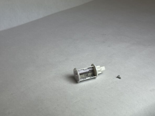

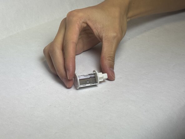

    9. Manual Pencil Sharpener Blade Replacement: step 9, image 1 of 2 Manual Pencil Sharpener Blade Replacement: step 9, image 2 of 2
      • Remove the screw holding down the razor blade.
      Ask FixBot
    10. Manual Pencil Sharpener Blade Replacement: step 10, image 1 of 3 Manual Pencil Sharpener Blade Replacement: step 10, image 2 of 3 Manual Pencil Sharpener Blade Replacement: step 10, image 3 of 3
      • Extract the razor blade.
      • Avoid grazing over the sides of the blade when picking up the part to prevent cuts.
      Ask FixBot
    11. Manual Pencil Sharpener Blade Replacement: step 11, image 1 of 3 Manual Pencil Sharpener Blade Replacement: step 11, image 2 of 3 Manual Pencil Sharpener Blade Replacement: step 11, image 3 of 3
      • Insert the new razor blade.
      • Avoid grazing the edges of the blade when inserting the razor.
      Ask FixBot
