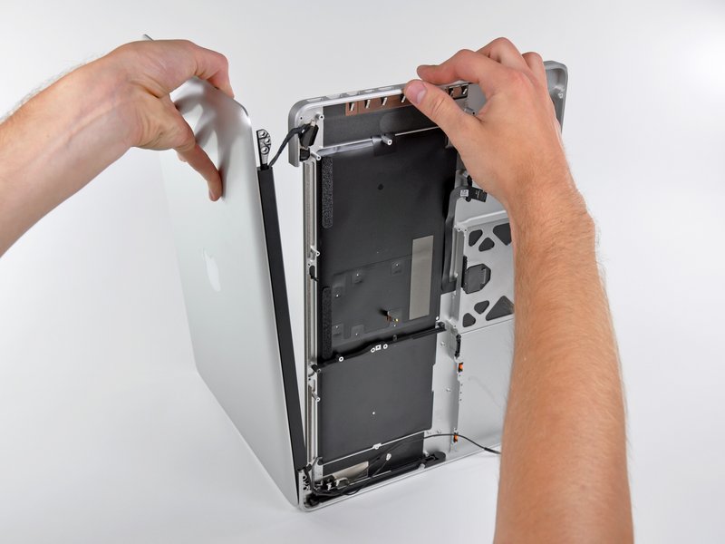

    15. MacBook Pro 15" Unibody Late 2011 Upper Case Replacement: step 37, image 1 of 2 MacBook Pro 15" Unibody Late 2011 Upper Case Replacement: step 37, image 2 of 2
      • Remove the 8.6 mm ( 7.0 mm ) Phillips screw securing the display data cable retainer to the top right portion of the upper case.
      • Remove the display data cable retainer from the upper case.
      Ask FixBot
    16. MacBook Pro 15" Unibody Late 2011 Upper Case Replacement: step 38, image 1 of 1
      • Remove two of the three 6 mm T6 Torx screws securing the right side of the display to the upper case.

    20. MacBook Pro 15" Unibody Late 2011 Upper Case Replacement: step 42, image 1 of 3 MacBook Pro 15" Unibody Late 2011 Upper Case Replacement: step 42, image 2 of 3 MacBook Pro 15" Unibody Late 2011 Upper Case Replacement: step 42, image 3 of 3
      • Grab the upper case with your right hand and rotate it slightly toward the top of the display so the upper display bracket clears the edge of the upper case.
      • Rotate the display slightly away from the upper case.
      • Lift the display up and away from the upper case, minding any brackets or cables that may get caught.
      Ask FixBot
