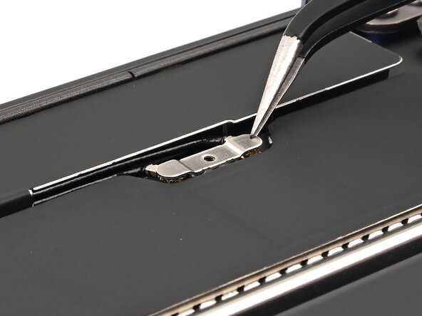

    1. MacBook Neo Logic Board Replacement, Remove the antenna connector cover: step 8, image 1 of 1
      • Use a Torx Plus 3IP driver to remove the 1.7 mm‑long screw securing the antenna connector cover.
      Ask FixBot
    2. MacBook Neo Logic Board Replacement: step 9, image 1 of 2 MacBook Neo Logic Board Replacement: step 9, image 2 of 2
      • Use tweezers or your fingers to remove the antenna connector cover.
      • During reassembly, make sure the edge with a protrusion is facing the antenna.
      Ask FixBot

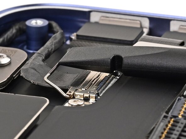

    9. MacBook Neo Logic Board Replacement, Disconnect the display cable: step 16, image 1 of 2 MacBook Neo Logic Board Replacement, Disconnect the display cable: step 16, image 2 of 2
      • Use the flat end of a spudger to gently push under the metal buckle of the display cable connector, located on the top‑right corner of the logic board, to unclip it.
      Ask FixBot
    10. MacBook Neo Logic Board Replacement: step 17, image 1 of 2 MacBook Neo Logic Board Replacement: step 17, image 2 of 2
      • Grab the buckle and cable together and gently pull the connector straight out of its socket.
      Ask FixBot

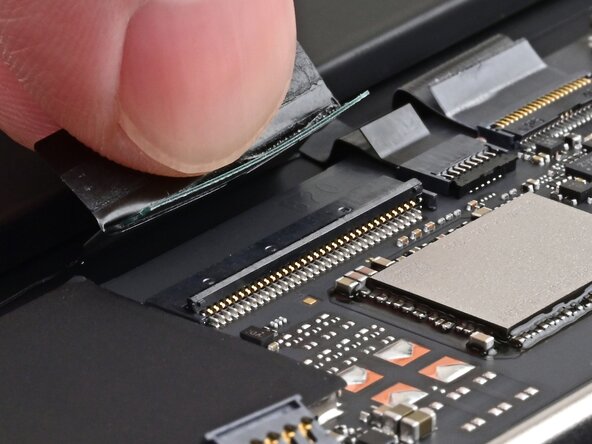

    12. MacBook Neo Logic Board Replacement, Lift the keyboard cable cover: step 19, image 1 of 2 MacBook Neo Logic Board Replacement, Lift the keyboard cable cover: step 19, image 2 of 2
      • Don't tear or fully remove this cover—it'll be used to disconnect the cable.
      • Use tweezers to peel up the black sticker over the keyboard cable, just until it comes off the socket on the board. Make sure it stays attached to the cable.
      Ask FixBot
    13. MacBook Neo Logic Board Replacement, Disconnect the keyboard: step 20, image 1 of 2 MacBook Neo Logic Board Replacement, Disconnect the keyboard: step 20, image 2 of 2
      • Use the flat end of a spudger to flip up the hinged locking flap on the keyboard cable ZIF connector.
      Ask FixBot
    14. MacBook Neo Logic Board Replacement: step 21, image 1 of 2 MacBook Neo Logic Board Replacement: step 21, image 2 of 2
      • Use tweezers or your fingers to gently grip the keyboard cable by its cover and slide the cable out of its socket.
      Ask FixBot
