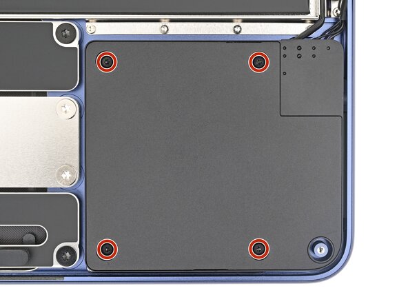

    3. MacBook Neo Left Speaker Replacement, Remove the left speaker screws: step 10, image 1 of 1
      • Use a Torx Plus 5IP driver to remove the four 3.5 mm‑long screws securing the left speaker.
      • During reassembly, press the left speaker against the frame of the MacBook while installing the screws.
      Ask FixBot
    4. MacBook Neo Left Speaker Replacement, Remove the left speaker: step 11, image 1 of 3 MacBook Neo Left Speaker Replacement, Remove the left speaker: step 11, image 2 of 3 MacBook Neo Left Speaker Replacement, Remove the left speaker: step 11, image 3 of 3
      • Lift the left speaker to a roughly 45‑degree angle and remove it.
      Ask FixBot
