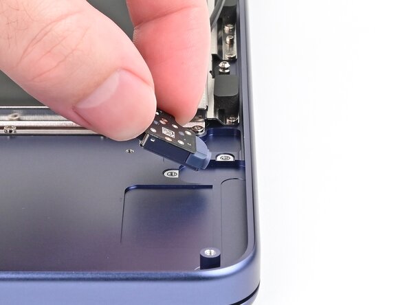

  15. MacBook Neo Headphone Jack Replacement, Remove the headphone jack: step 15, image 1 of 3 MacBook Neo Headphone Jack Replacement, Remove the headphone jack: step 15, image 2 of 3 MacBook Neo Headphone Jack Replacement, Remove the headphone jack: step 15, image 3 of 3
    • Lift the headphone jack to a roughly 45‑degree angle and remove it.
