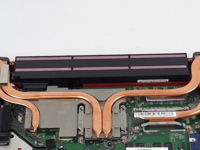

    1. MSI GE62 6QF Apache Pro Battery Replacement, Battery: step 6, image 1 of 3 MSI GE62 6QF Apache Pro Battery Replacement, Battery: step 6, image 2 of 3 MSI GE62 6QF Apache Pro Battery Replacement, Battery: step 6, image 3 of 3
      • Remove the single PH #0 5mm screw holding the battery pack in place.
      • Remove the battery by sliding it away from the computer.
      Ask FixBot
