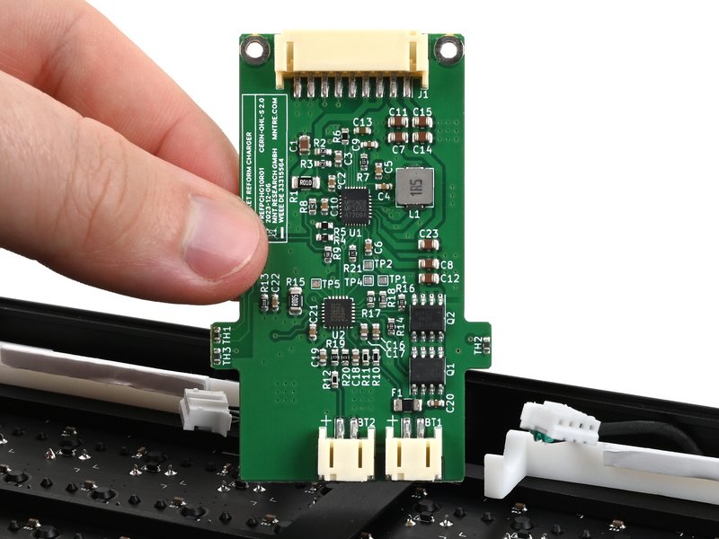

Use this guide to replace the charger board in your MNT Pocket Reform laptop.
If your Pocket Reform has good batteries but charges slowly or not at all, or if the device overheats while charging, you may need to replace the charger board.
You can find the charger board CAD file on MNT's documentation page.

    1. MNT Pocket Reform Charger Board Replacement, Disconnect the charger board: step 7, image 1 of 3 MNT Pocket Reform Charger Board Replacement, Disconnect the charger board: step 7, image 2 of 3 MNT Pocket Reform Charger Board Replacement, Disconnect the charger board: step 7, image 3 of 3
      • Use a pair of angled tweezers to disconnect the two sliding connectors from the charger board.
      Ask FixBot
    2. MNT Pocket Reform Charger Board Replacement, Remove the charger board screws: step 8, image 1 of 2 MNT Pocket Reform Charger Board Replacement, Remove the charger board screws: step 8, image 2 of 2
      • Use a Phillips screwdriver to remove the two 4.8 mm‑long screws securing the charger board.
      Ask FixBot
    3. MNT Pocket Reform Charger Board Replacement, Remove the charger board: step 9, image 1 of 2 MNT Pocket Reform Charger Board Replacement, Remove the charger board: step 9, image 2 of 2
      • Remove the charger board.
      Ask FixBot
