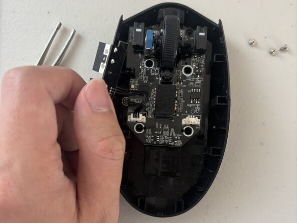

  10. MCHOSE G3 Ultra 8K Scroll Wheel Replacement: step 10, image 1 of 2 MCHOSE G3 Ultra 8K Scroll Wheel Replacement: step 10, image 2 of 2
    • Use a Phillips #1 screwdriver to remove the four screws on the motherboard.
    • Potential for device damage. Do not attempt to lift the motherboard after unscrewing the four screws.
    Ask FixBot
  11. MCHOSE G3 Ultra 8K Scroll Wheel Replacement: step 11, image 1 of 3 MCHOSE G3 Ultra 8K Scroll Wheel Replacement: step 11, image 2 of 3 MCHOSE G3 Ultra 8K Scroll Wheel Replacement: step 11, image 3 of 3
    • Gently remove the daughterboard for the side buttons which is located near the side buttons.
    • Simply slide out the two rectangles with a firm grip and leave it hanging outside of the mouse.
    Ask FixBot
  12. MCHOSE G3 Ultra 8K Scroll Wheel Replacement: step 12, image 1 of 2 MCHOSE G3 Ultra 8K Scroll Wheel Replacement: step 12, image 2 of 2
    • Use your fingers or tweezers to detach the remaining cable connector located on the bottom left of the motherboard.
    Ask FixBot

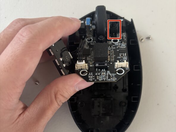

  13. MCHOSE G3 Ultra 8K Scroll Wheel Replacement: step 13, image 1 of 3 MCHOSE G3 Ultra 8K Scroll Wheel Replacement: step 13, image 2 of 3 MCHOSE G3 Ultra 8K Scroll Wheel Replacement: step 13, image 3 of 3
    • Gently lift the motherboard upwards so the metal spring located on the right side of the scroll wheel is not visible.
    Ask FixBot
