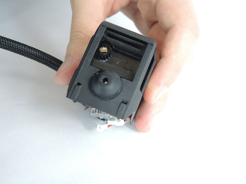

      • Slide the tracks off the second slider and remove the printer head and x-tracks from the center of the printer. To remove the front cover of the print head, firmly grip the cover and gently pull it off.

      • Disconnect the red and black wires at the white connector. They should easily separate.
