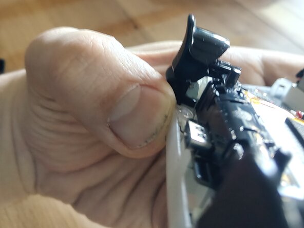

    3. Loose RT/LT with Trigger Switch Gear engaged: step 4, image 1 of 3 Loose RT/LT with Trigger Switch Gear engaged: step 4, image 2 of 3 Loose RT/LT with Trigger Switch Gear engaged: step 4, image 3 of 3
      • Put back in place the pin of trigger. Push gently, untill support.
      • 2 firsts photos are the working trigger. 3rd one is the "broken" one. Push from exterior to interior of the controller. The pin's shape's nail. Take time to check alignment and spring position.
      Ask FixBot
      • Check triggers are working.
      • Battery on place.
      • Clip the back panel. Check if on place everywhere.
      • Screw the seven screws.
