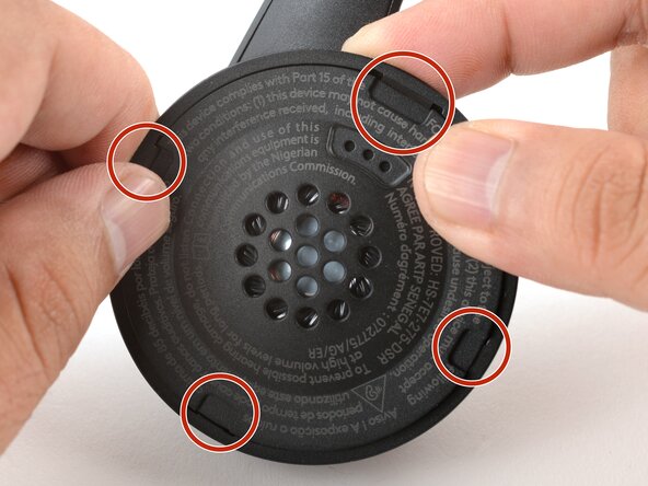

    1. Logitech Zone 305 Battery Replacement, Separate the speaker plate: step 3, image 1 of 3 Logitech Zone 305 Battery Replacement, Separate the speaker plate: step 3, image 2 of 3 Logitech Zone 305 Battery Replacement, Separate the speaker plate: step 3, image 3 of 3
      • Insert the point of an opening pick into the seam between the speaker plate and ear cup.
      • Slide the pick along the seam to release the four speaker plate clips.

    23. Logitech Zone 305 Battery Replacement: step 25, image 1 of 3 Logitech Zone 305 Battery Replacement: step 25, image 2 of 3 Logitech Zone 305 Battery Replacement: step 25, image 3 of 3
      • Use your fingers to squeeze and engage the four clips to secure the speaker plate to the housing.
