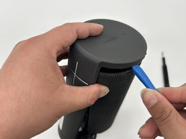

    2. Logitech UE Megablast Motherboard Replacement: step 2, image 1 of 3 Logitech UE Megablast Motherboard Replacement: step 2, image 2 of 3 Logitech UE Megablast Motherboard Replacement: step 2, image 3 of 3
      • Insert the blue iFixit opening tool between the rubber end and the mesh.
      • Pry the rubber end to remove it.

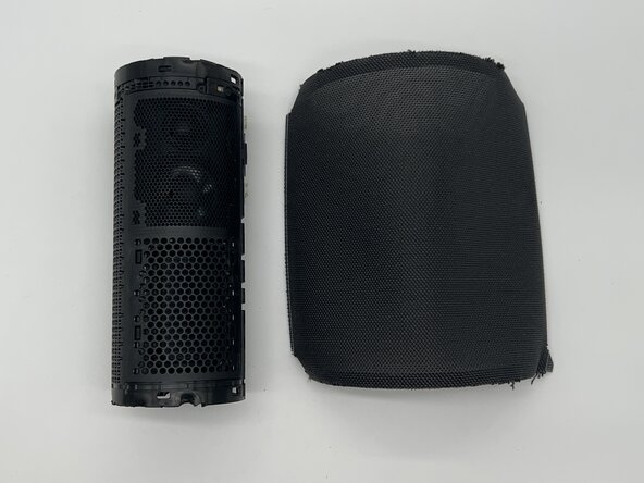

    6. Logitech UE Megablast Motherboard Replacement: step 11, image 1 of 2 Logitech UE Megablast Motherboard Replacement: step 11, image 2 of 2
      • Carefully remove the mesh and set it aside for reassembly.
      Ask FixBot
    7. Logitech UE Megablast Motherboard Replacement: step 12, image 1 of 3 Logitech UE Megablast Motherboard Replacement: step 12, image 2 of 3 Logitech UE Megablast Motherboard Replacement: step 12, image 3 of 3
      • Use the iFixit opening tool to release the clips along the seam, starting at a corner or the side
      • Gently lift the plastic cover away from the body to expose the speaker underneath.
