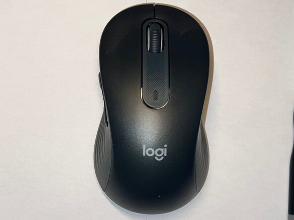

Logitech Signature M650 L Scroll Wheel Assembly Replacement
    1. Logitech Signature M650 L Scroll Wheel Assembly Replacement, Scroll Wheel Assembly: step 1, image 1 of 3 Logitech Signature M650 L Scroll Wheel Assembly Replacement, Scroll Wheel Assembly: step 1, image 2 of 3 Logitech Signature M650 L Scroll Wheel Assembly Replacement, Scroll Wheel Assembly: step 1, image 3 of 3

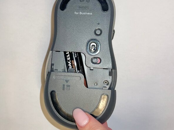

      • Slide the battery compartment cover downward and lift it away from the mouse.
      Ask FixBot
    2. Logitech Signature M650 L Scroll Wheel Assembly Replacement: step 2, image 1 of 1
      • Remove the AA battery from the battery compartment.
      Ask FixBot

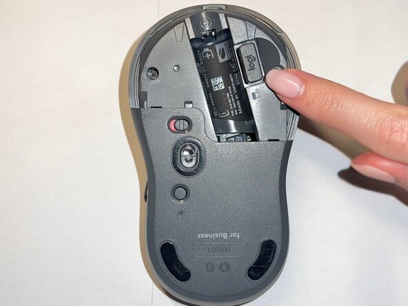

    3. Logitech Signature M650 L Scroll Wheel Assembly Replacement: step 3, image 1 of 2 Logitech Signature M650 L Scroll Wheel Assembly Replacement: step 3, image 2 of 2
      • Remove the USB receiver from its storage slot inside the battery compartment.
      Ask FixBot

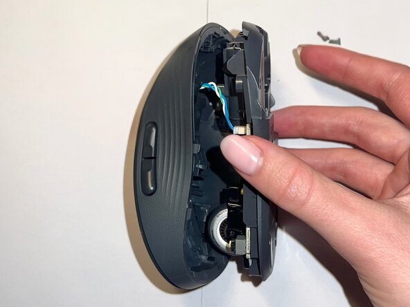

    5. Logitech Signature M650 L Scroll Wheel Assembly Replacement: step 5, image 1 of 2 Logitech Signature M650 L Scroll Wheel Assembly Replacement: step 5, image 2 of 2
      • Gently lift the top shell away from the mouse body.
      • Do not remove it completely, as it is still connected to the base by a cable.
      Ask FixBot
    6. Logitech Signature M650 L Scroll Wheel Assembly Replacement: step 6, image 1 of 1
      • Use a Phillips #000 screwdriver to remove the two screws securing the scroll wheel assembly.
      Ask FixBot
    7. Logitech Signature M650 L Scroll Wheel Assembly Replacement: step 7, image 1 of 2 Logitech Signature M650 L Scroll Wheel Assembly Replacement: step 7, image 2 of 2
      • Lift the scroll wheel assembly out of the mouse and install the replacement assembly in the same position.
