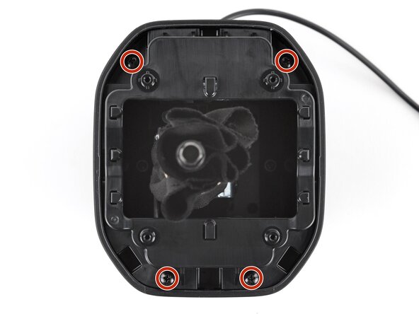

    1. Logitech RS H‑Shifter USB Cable Replacement, Remove the top cover: step 3, image 1 of 2 Logitech RS H‑Shifter USB Cable Replacement, Remove the top cover: step 3, image 2 of 2
      • Use a 2.5 mm hex screwdriver to remove the four 12 mm‑long screws securing the top cover.

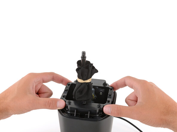

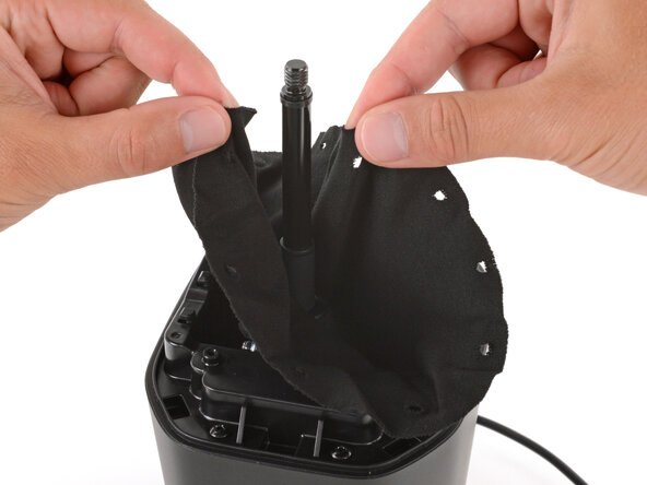

    1. Logitech RS H‑Shifter USB Cable Replacement, Secure the gaiter: step 5, image 1 of 3 Logitech RS H‑Shifter USB Cable Replacement, Secure the gaiter: step 5, image 2 of 3 Logitech RS H‑Shifter USB Cable Replacement, Secure the gaiter: step 5, image 3 of 3
      • Completely unhook the fabric gaiter and use a rubber band to secure it to the shift lever.
      • During reassembly, hook the fabric back into its eight clips and four screw posts. You'll need to double up the fabric on the hooks.

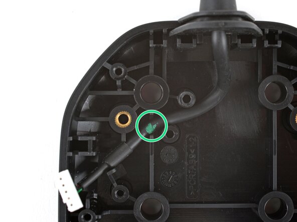

    1. Logitech RS H‑Shifter USB Cable Replacement, Remove the USB cable: step 13, image 1 of 3 Logitech RS H‑Shifter USB Cable Replacement, Remove the USB cable: step 13, image 2 of 3 Logitech RS H‑Shifter USB Cable Replacement, Remove the USB cable: step 13, image 3 of 3
      • Remove the USB cable.
      • During reassembly:
      • Use the second photo to ensure the cable is properly routed through the grooves on the base. The cable marking should sit in the groove.
      • Make sure there are no gaps on the back edge where the rubber gasket meets the base.
