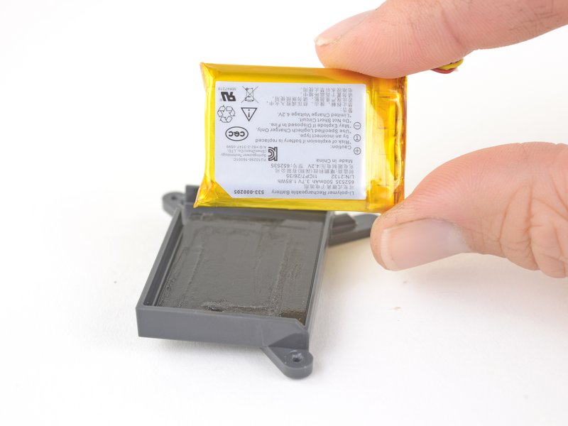

    4. Logitech MX Master 3 for Mac Battery Replacement, Soften the battery adhesive: step 14, image 1 of 1
      • The battery is secured within its housing by some light adhesive.
      • Flip the battery housing over so the battery is facing down.
      • Apply a heated iOpener to the battery housing for about 2 minutes to soften the battery adhesive.
      Ask FixBot
    5. Logitech MX Master 3 for Mac Battery Replacement, Separate the battery adhesive: step 15, image 1 of 2 Logitech MX Master 3 for Mac Battery Replacement, Separate the battery adhesive: step 15, image 2 of 2
      • Insert the long edge of an opening pick between the battery and its housing at the side opposite the battery cable.
      • Push the opening pick under the battery and lift up to pry the battery out of its housing.
      • Make sure you push underneath the battery and not into it. Don't bend, crease, deform, poke, or puncture the battery—a damaged battery is a potential fire hazard.
      • If you encounter significant resistance, pause and reheat the adhesive.
      Ask FixBot
    6. Logitech MX Master 3 for Mac Battery Replacement, Remove the battery: step 16, image 1 of 2 Logitech MX Master 3 for Mac Battery Replacement, Remove the battery: step 16, image 2 of 2
      Tool used on this step:
      Tesa 61395 Tape
      $8.95
      Buy
      • Remove the battery.
      • To install a new battery:
      • Use a spudger or your fingers to peel any old adhesive off of the battery housing. The old adhesive shouldn't leave any residue.
      • If your new battery doesn't come with preinstalled adhesive, place a couple strips of double-sided tape into the battery housing.
      • Orient your new battery so its cables route through the cutout in the corner of the housing. Press the battery firmly into place to secure it.
      Ask FixBot
