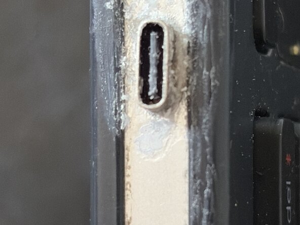

  8. Logitech K830 Broken Micro usb to usb-C Replacement: step 8, image 1 of 1
    • You can use a soldering iron to enlarge the hole where the usb connector comes out , go slow
    • pro tip ** use a spare connector to test and push into the hole until you are satisfied , take your time you want it to be super snug since that’s basically what’s holding the connector in place .
    • You can then push the real usbC connector in place and use crazy glue INSIDE to reinforce . I put some inside and outside and it’s very ugly , I have to clean it all up .
