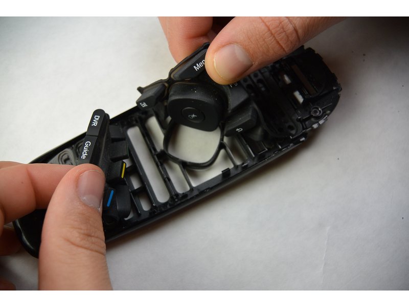

    5. Logitech Harmony Smart Control Remote Buttons Replacement: step 5, image 1 of 1
      • From the front of the remote, remove the buttons. Clean or replace the necessary buttons.
