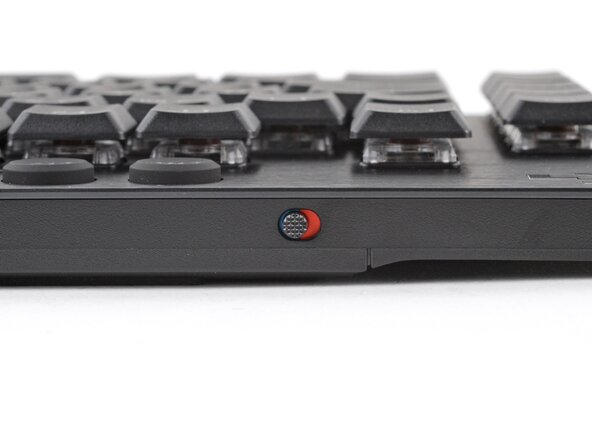

      • Slide the power switch on the top edge of the keyboard to the OFF position.
      • A red indicator should be visible beneath the switch.
      • Unplug all cables from your keyboard.

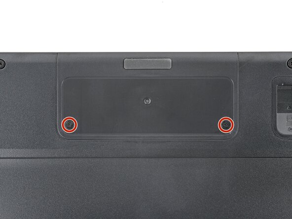

    1. Logitech G915 X Lightspeed Battery Replacement, Remove the battery cover sticker: step 2, image 1 of 2 Logitech G915 X Lightspeed Battery Replacement, Remove the battery cover sticker: step 2, image 2 of 2
      • The Logitech sticker hides two battery cover screws.
      • Heat an iOpener and lay it on the Logitech sticker for one minute.
      • Alternatively, you can use a hair dryer to heat the sticker. Make sure it's on the Low setting to avoid warping the plastic.

    3. Logitech G915 X Lightspeed Battery Replacement, Remove the battery cover screws: step 4, image 1 of 2 Logitech G915 X Lightspeed Battery Replacement, Remove the battery cover screws: step 4, image 2 of 2
      • Use a Phillips screwdriver to remove the two 4 mm‑long screws securing the battery cover.
