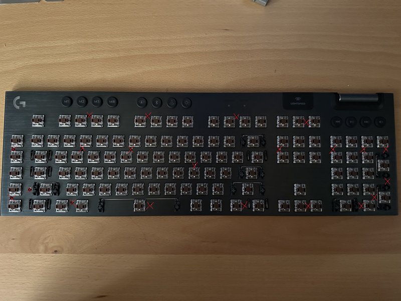

This is a guide used if a switch replacement is needed or in my case if a keycap breaks off inside of your switch, rendering the switch inoperable. I will be using colors to refer to different sets of screws. This is NOT a TKL model so the screws under the feet are in different places from the full size G915 in this guide.
Tools
    1. Logitech G915 Wireless: Key switch repair/replacement, Removing Front Screws: step 1, image 1 of 1
      • Remove all of the screws (red set) on this keyboard using a PH1 size Philips bit.
      • You can remove all the keycaps or just remove the necessary keycaps surrounding the screw heads.
      • Make sure you press down firmly when unscrewing to prevent stripping the screw head.

Keycaps which need to be extracted (minimum required) for clearing front screws, in text format:
f2 f3
f5 f6
f10 f11
sl ss
w 3
t 6
o l
ins del
num 7
* 9
+3
. 0
bot right arrows
r ctrl menu
l win alt
l shift
g1 g2
g4 g5
space
