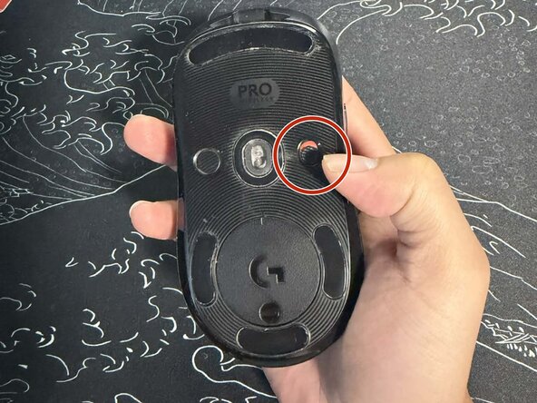

    2. Logitech G Pro Wireless Mouse Side Button Switch Replacement: step 2, image 1 of 1
      • Flip the power switch to OFF.
      • The power switch is located on the bottom of the mouse.

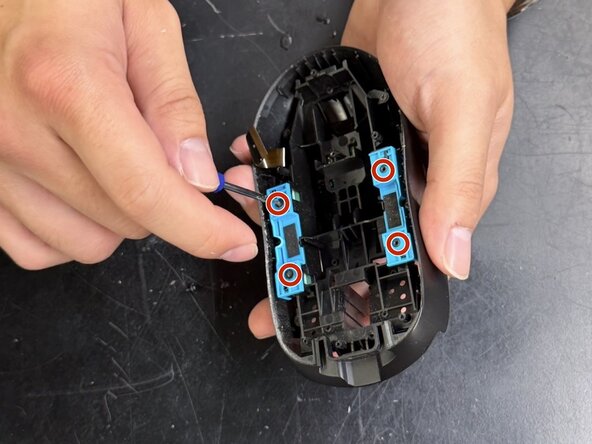

    11. Logitech G Pro Wireless Mouse Side Button Switch Replacement: step 11, image 1 of 3 Logitech G Pro Wireless Mouse Side Button Switch Replacement: step 11, image 2 of 3 Logitech G Pro Wireless Mouse Side Button Switch Replacement: step 11, image 3 of 3
      • Using the screwdriver, remove the four 3mm Phillips #00 screws securing the blue side button brackets on both sides of the mouse.
      • Remove the nine 3 mm-long Phillips #00 screws securing the main internal frame (black plastic structure).
      • Remove the single 3mm Phillips #00 screw at the top of the mouse near the front end.
      • Set all screws aside in an organized manner to avoid mixing them up.
