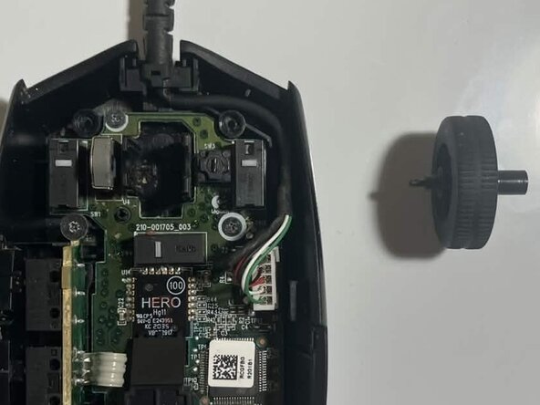

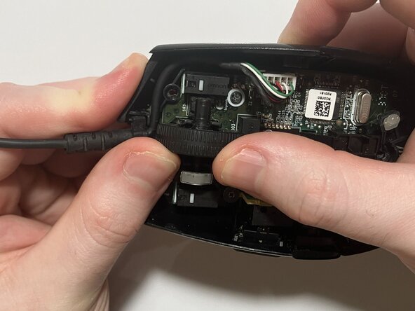

  5. Logitech G Pro Wired Mouse M-U0052 Wheel Replacement: step 5, image 1 of 3 Logitech G Pro Wired Mouse M-U0052 Wheel Replacement: step 5, image 2 of 3 Logitech G Pro Wired Mouse M-U0052 Wheel Replacement: step 5, image 3 of 3
    • To remove the mouse wheel, apply moderate pressure from the left side of the mouse wheel to pop it out.
    • To install a new mouse wheel, it should slide into the socket with a little pressure in the same way. Make sure the wheel part lines up with the socket, approaching from the right side.
