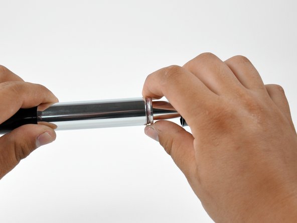

  7. Lezyne Pressure Drive O-Ring Set Replacement: step 7, image 1 of 1
    • Use your finger to remove the bump-stop O-ring from below the pump's outlet cap threads.
    • Place a new bump stop O-ring into the pump.
    • The O-ring can be inserted into the other side of the pump body. As long as it is straight, the pump plunger will push it down to it's proper place.
    • Be sure the O-ring is not in any of the pump body's threads or it may become damaged during re-assembly.
