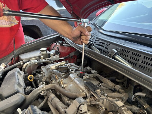

      • Use a 3/8-inch drive ratchet with a 6-inch (or longer) extension and a 14 mm (9/16-inch) thin-wall spark plug socket to loosen the four spark plugs.
