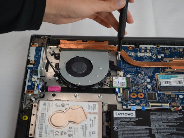

    1. Lenovo V15-IIL 82C5 Fan Replacement, Fan: step 4, image 1 of 3 Lenovo V15-IIL 82C5 Fan Replacement, Fan: step 4, image 2 of 3 Lenovo V15-IIL 82C5 Fan Replacement, Fan: step 4, image 3 of 3
      • Remove the three Phillips #000 screws securing the fan.
      Ask FixBot

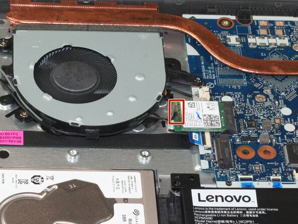

    2. Lenovo V15-IIL 82C5 Fan Replacement: step 5, image 1 of 1
      • Use the tip of a spudger to pry up and disconnect the two Wi-Fi card antenna connectors.
      • Unseat the antenna cables from the fan retaining hooks.
