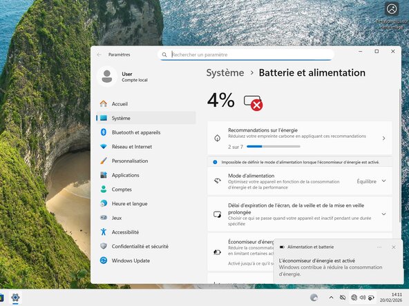

      • Let the laptop’s battery level drop below 25% before beginning the repair, as a fully charged battery could pose a fire risk if damaged.
      • Disconnect all cables and completely power off the laptop.

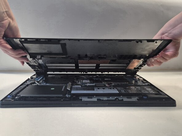

    6. Lenovo V15 G2 IJL RAM Replacement: step 6, image 1 of 2 Lenovo V15 G2 IJL RAM Replacement: step 6, image 2 of 2
      • Remove the back cover.
      • During reassembly, snap the top corners of the back cover with the tabs on the plate. Press down firmly alongside the edges to fit back together the back cover and the hinge cover.
