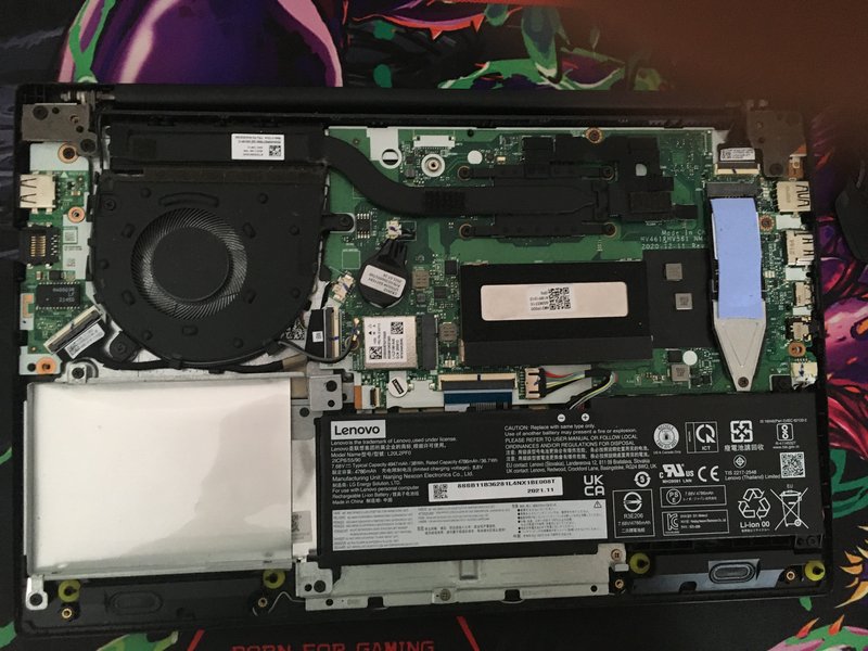

      • Lift the panel from the top and you will have access to the motherboard
      Ask FixBot
    5. Lenovo V14 G2 ALC RAM Replacement, Discovering the RAM cover: step 6, image 1 of 1
      • This is the ram cover that you need to get open.
      Ask FixBot
    6. Lenovo V14 G2 ALC RAM Replacement, Opening the ram cover: step 7, image 1 of 2 Lenovo V14 G2 ALC RAM Replacement, Opening the ram cover: step 7, image 2 of 2
