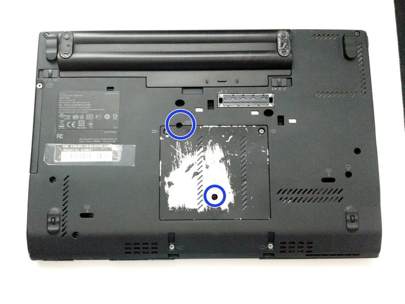

    1. Lenovo Thinkpad X220 Keyboard Replacement, Keyboard: step 4, image 1 of 1
      • Put the laptop upside down.
      • Unscrew the two keyboard retention screws.
      Ask FixBot
