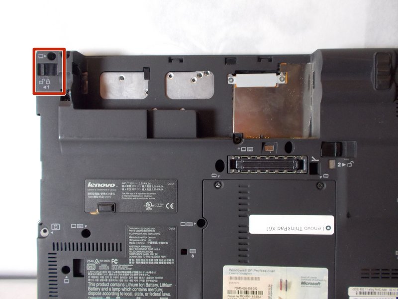

      • The first step to replacing your insufficient battery is to flip your device to the back side, with the battery on top.
      • You should then find the battery lock release located in the top left corner, as indicated in the image.

    2. Lenovo ThinkPad X61 Battery Replacement: step 2, image 1 of 1
      • The next step is to simply move the switch from the locked position to the unlocked position.
      Ask FixBot
    3. Lenovo ThinkPad X61 Battery Replacement: step 3, image 1 of 1
      • Next, you find the second lock release switch located under the bottom right of the battery holder as marked in the image.
      • Simply move the switch over from the locked position to the unlocked position and pull the battery from its holder. You can now insert the new battery.
