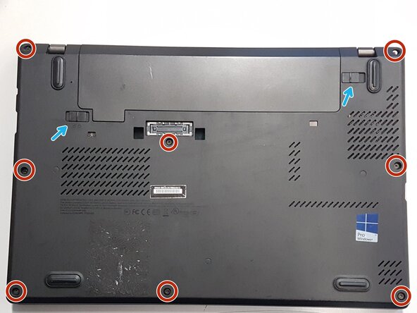

    1. Lenovo ThinkPad X250 HDD/SSD Replacement, Remove the back cover.: step 1, image 1 of 3 Lenovo ThinkPad X250 HDD/SSD Replacement, Remove the back cover.: step 1, image 2 of 3 Lenovo ThinkPad X250 HDD/SSD Replacement, Remove the back cover.: step 1, image 3 of 3
      • Ensure to disable the internal battery. Turn on the laptop and press F1/F2/Enter at the Lenovo logo screen to open the BIOS. Use the arrow keys to find the Configuration tab. Select Power. Choose Disable Built-in Battery and press Enter. Select Yes on the confirmation pop-up window.
      • Physically remove battery 2. Release it by pushing clips 1 and 2 highlighted with blue arrows, then slide out the battery.
      • Unscrew the 8 screws holding the back panel in place
      • Use a plastic prying tool to release all the clips holding the panel in place.
