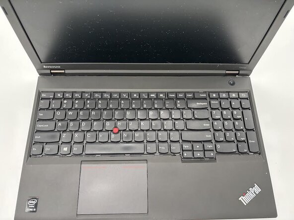

    1. Lenovo ThinkPad T540P Keyboard Replacement, Keyboard: step 4, image 1 of 3 Lenovo ThinkPad T540P Keyboard Replacement, Keyboard: step 4, image 2 of 3 Lenovo ThinkPad T540P Keyboard Replacement, Keyboard: step 4, image 3 of 3
      • Use a spudger to push in the three tabs on the lower edge of the keyboard, toward the display.

    2. Lenovo ThinkPad T540P Keyboard Replacement: step 5, image 1 of 3 Lenovo ThinkPad T540P Keyboard Replacement: step 5, image 2 of 3 Lenovo ThinkPad T540P Keyboard Replacement: step 5, image 3 of 3
      • If the screws are not visible push the plastic in-between the keys more.
      • Unscrew all six M2 x 2.5 mm captive screws in the keyboard with a Phillips #000 screwdriver.

    3. Lenovo ThinkPad T540P Keyboard Replacement: step 6, image 1 of 2 Lenovo ThinkPad T540P Keyboard Replacement: step 6, image 2 of 2
      • Gently lift and rotate the keyboard so the the far edge is now the closest edge to you and the back side of the keyboard is showing.
      • Take care not to strain the connected ribbon cable.

    4. Lenovo ThinkPad T540P Keyboard Replacement: step 7, image 1 of 2 Lenovo ThinkPad T540P Keyboard Replacement: step 7, image 2 of 2
      • Flip up the black locking flap that secures the keyboard ribbon cable to the motherboard.
      • Disconnect the ribbon cable.
      • Remove the keyboard.
