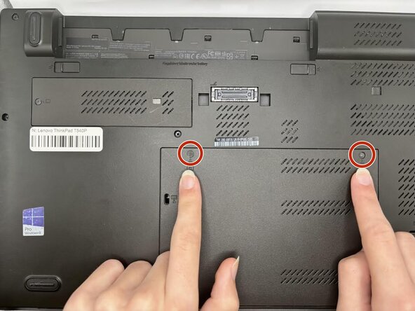

    1. Lenovo ThinkPad T540P HDD Replacement, HDD: step 4, image 1 of 3 Lenovo ThinkPad T540P HDD Replacement, HDD: step 4, image 2 of 3 Lenovo ThinkPad T540P HDD Replacement, HDD: step 4, image 3 of 3
      • Loosen the two M2 x 5mm captive screws on the large back panel with a Phillips #1 screwdriver.

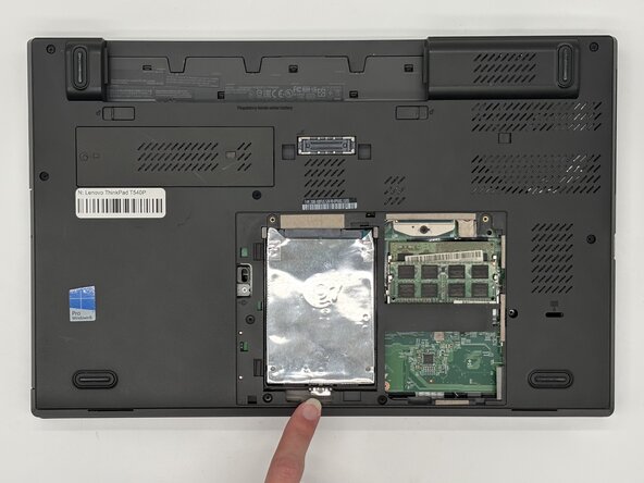

    2. Lenovo ThinkPad T540P HDD Replacement: step 5, image 1 of 1
      • Locate the hard drive and the single Phillips screw holding it in place.

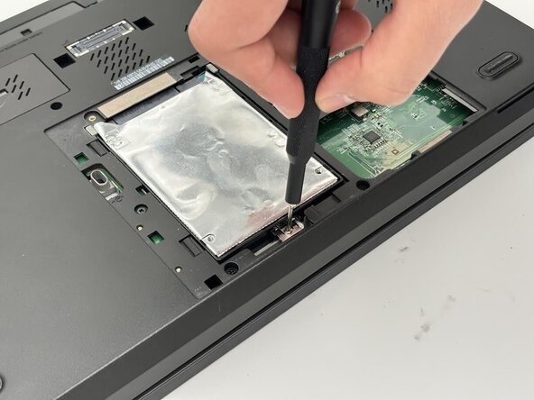

    3. Lenovo ThinkPad T540P HDD Replacement: step 6, image 1 of 2 Lenovo ThinkPad T540P HDD Replacement: step 6, image 2 of 2
      • This screw is not captive, so keep track of where you place it.
      • Remove the single M2 x 3 mm screw that is holding the hard drive in place with a #1 Phillips screwdriver.
