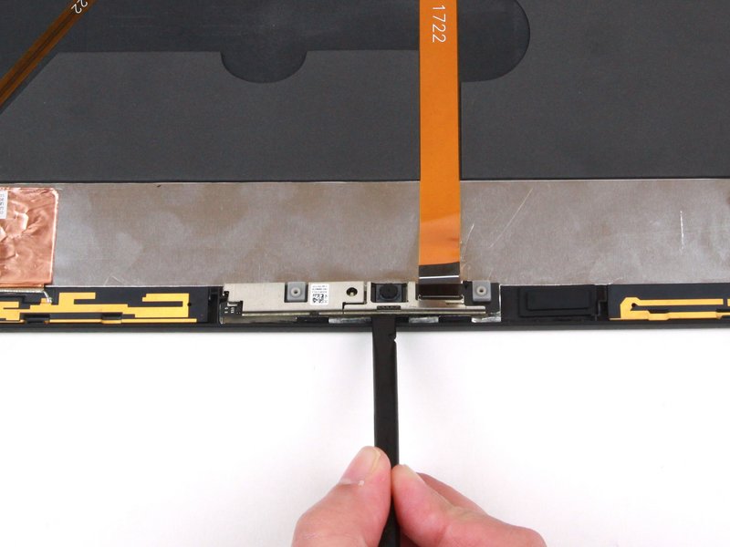

      • Use the flat end of a spudger to flip up the metal bracket securing the camera cable to the motherboard.
      Ask FixBot
    10. Lenovo ThinkPad T470 Webcam Replacement: step 40, image 1 of 2 Lenovo ThinkPad T470 Webcam Replacement: step 40, image 2 of 2
      • Use the flat end of a spudger to disconnect the camera cable from its socket on the motherboard.
      Ask FixBot

    3. Lenovo ThinkPad T470 Webcam Replacement: step 65, image 1 of 3 Lenovo ThinkPad T470 Webcam Replacement: step 65, image 2 of 3 Lenovo ThinkPad T470 Webcam Replacement: step 65, image 3 of 3
      • Use a spudger to pry the webcam up from the display assembly.
      • Use your hand to lift the webcam up and away from the laptop.
