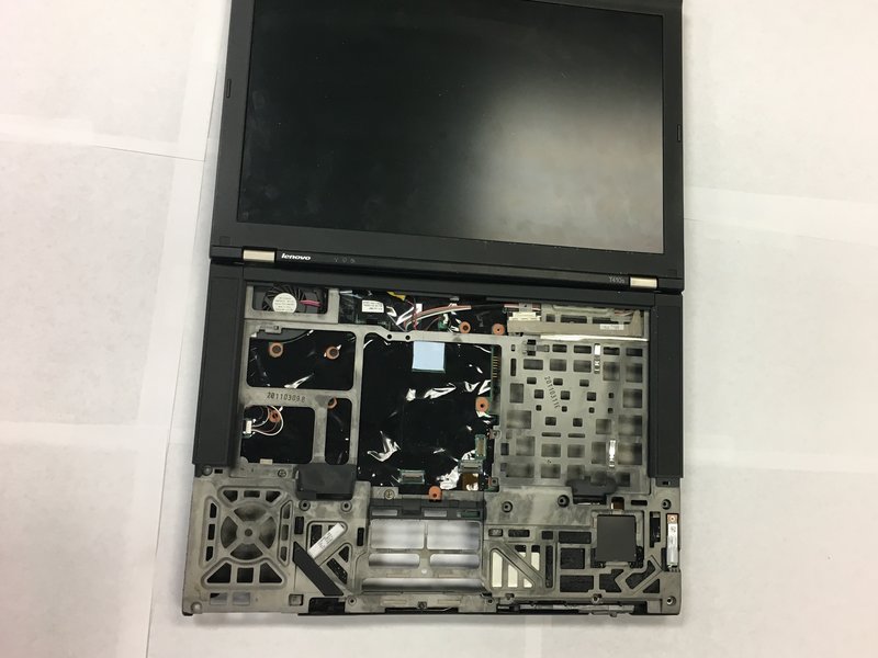

    1. Lenovo ThinkPad T410s Palm-rest Replacement, Palm-rest: step 8, image 1 of 1
      • Remove the twelve Phillips #0 screws from the back panel.
      Ask FixBot
    2. Lenovo ThinkPad T410s Palm-rest Replacement: step 9, image 1 of 2 Lenovo ThinkPad T410s Palm-rest Replacement: step 9, image 2 of 2
      • Up the flat end of a spudger to lift up the black tab on the ZIF connector.
      • Pull out the ribbon connector from the ZIF connector.
      Ask FixBot
    3. Lenovo ThinkPad T410s Palm-rest Replacement: step 10, image 1 of 2 Lenovo ThinkPad T410s Palm-rest Replacement: step 10, image 2 of 2
      • Remove the palm rest from the laptop.
      Ask FixBot
