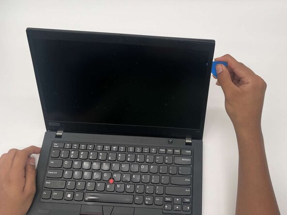

      • Turn off your laptop completely before starting the disassembly process.
      • Be careful when removing the bezel as it breaks easily.
      • Insert a plastic opening pick between the screen and the plastic bezel on the side.
      • Slide the opening pick along the edge of the screen to release clips that secure the bezel.
      • The popping sounds during this process is normal.

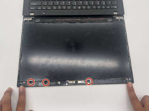

    3. Lenovo ThinkPad T14 Gen 1 Screen Replacement: step 3, image 1 of 2 Lenovo ThinkPad T14 Gen 1 Screen Replacement: step 3, image 2 of 2
      • Pull on the tabs until they fully come out.
      • These are not reusable.
