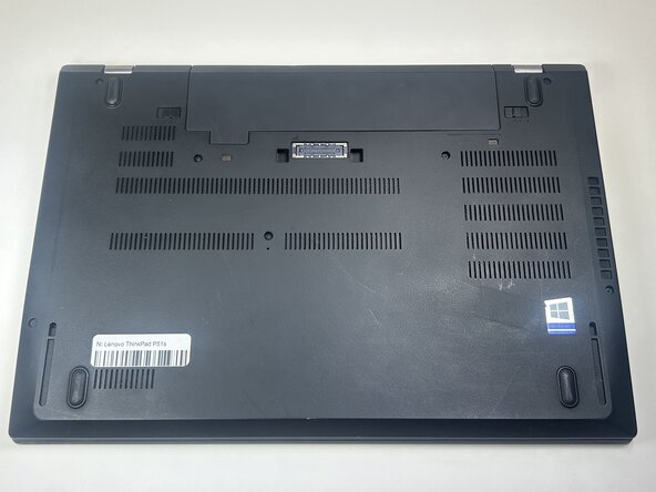

      • Flip the laptop so the bottom is facing up.
      • Place it on a soft cloth so you don’t scratch the lid.

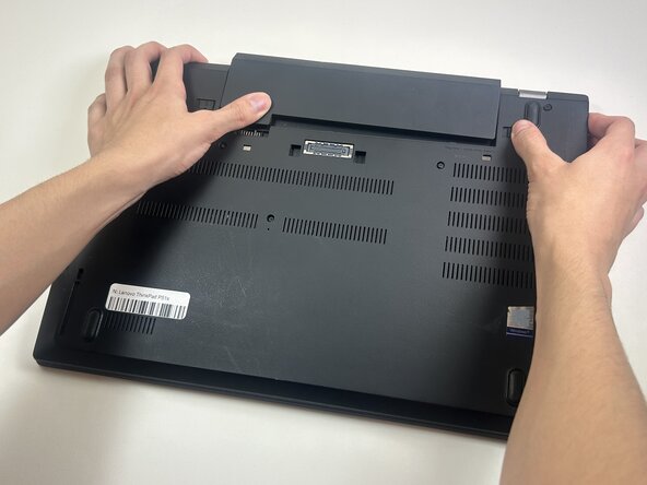

    2. Lenovo ThinkPad P51s RAM Replacement: step 2, image 1 of 3 Lenovo ThinkPad P51s RAM Replacement: step 2, image 2 of 3 Lenovo ThinkPad P51s RAM Replacement: step 2, image 3 of 3
      • Slide both locking latches outward using your thumbs.
      • Keep the right latch held in the unlocked position with your right thumb. With your left hand, pushed the battery out of its placement from the slot.
      • Once it detaches, use both hands to slide the battery out.
