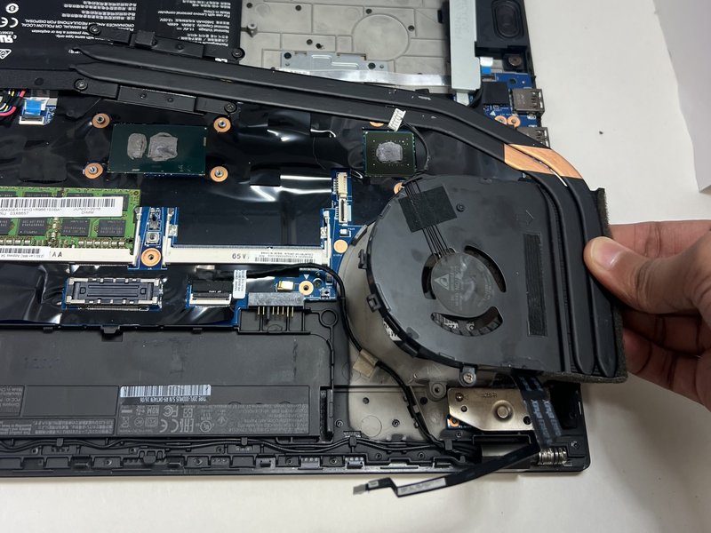

      • Use a Phillips #00 screwdriver to loosen the seven 2.5 mm captive screws securing the fan assembly to the motherboard.
      Ask FixBot
    4. Lenovo ThinkPad P50s Fan Assembly Replacement: step 13, image 1 of 3 Lenovo ThinkPad P50s Fan Assembly Replacement: step 13, image 2 of 3 Lenovo ThinkPad P50s Fan Assembly Replacement: step 13, image 3 of 3
      • Gently peel back the power button cable.
      Ask FixBot
    5. Lenovo ThinkPad P50s Fan Assembly Replacement: step 14, image 1 of 3 Lenovo ThinkPad P50s Fan Assembly Replacement: step 14, image 2 of 3 Lenovo ThinkPad P50s Fan Assembly Replacement: step 14, image 3 of 3
      • Lift the fan off the board to remove it.
      Ask FixBot
