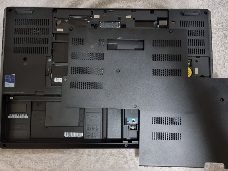

This is a guide on how to replace the bottom case on the Lenovo ThinkPad P50

    1. Lenovo ThinkPad P50 Lower Case Replacement, Battery: step 1, image 1 of 2 Lenovo ThinkPad P50 Lower Case Replacement, Battery: step 1, image 2 of 2
      • Slide the battery latch to the left to unlock it and remove the battery.

    2. Lenovo ThinkPad P50 Lower Case Replacement, Bottom case screws: step 2, image 1 of 1
      • Loosen the six 12.6 mm captive screws that secure the lower case with the Phillips #00 screwdriver.
      • The screws will not come all the way out; do not attempt to remove them from the case.
      • Pull up the notch with your fingernail or a spudger.

    3. Lenovo ThinkPad P50 Lower Case Replacement, Bottom case: step 3, image 1 of 2 Lenovo ThinkPad P50 Lower Case Replacement, Bottom case: step 3, image 2 of 2
      • Lift the lower case up and off of the chassis.
