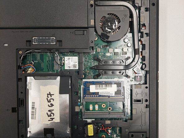

  1. Lenovo ThinkPad L560 Thermal Paste Replacement, Opening the back panel: step 1, image 1 of 3 Lenovo ThinkPad L560 Thermal Paste Replacement, Opening the back panel: step 1, image 2 of 3 Lenovo ThinkPad L560 Thermal Paste Replacement, Opening the back panel: step 1, image 3 of 3
    • Unscrew all screws holding the back panel in place.
    • Remove the battery.
    • Unscrew the 4 screws holding the CPU heatsink and disconnect the fan.
    Ask FixBot

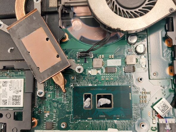

  2. Lenovo ThinkPad L560 Thermal Paste Replacement, Changing the thermal paste: step 2, image 1 of 3 Lenovo ThinkPad L560 Thermal Paste Replacement, Changing the thermal paste: step 2, image 2 of 3 Lenovo ThinkPad L560 Thermal Paste Replacement, Changing the thermal paste: step 2, image 3 of 3
    • Clean the old thermal paste from both the cooler and the CPU.
    • Use isopropyl alcohol and cotton swabs or paper towel, but be careful not to press too hard on the CPU.
    • It's also recommended to use compressed air to remove any dust in the laptop and the fan.
    • Use only enough thermal paste to cover a portion of the pad. Use a spreader if you have one.
    • The thermal paste will apply evenly after you tighten the heatsink.
    • Place the heatsink back into the unit carefully and tighten the screws in an "X" pattern to ensure even pressure. Don't forget to plug in the fan cable.
