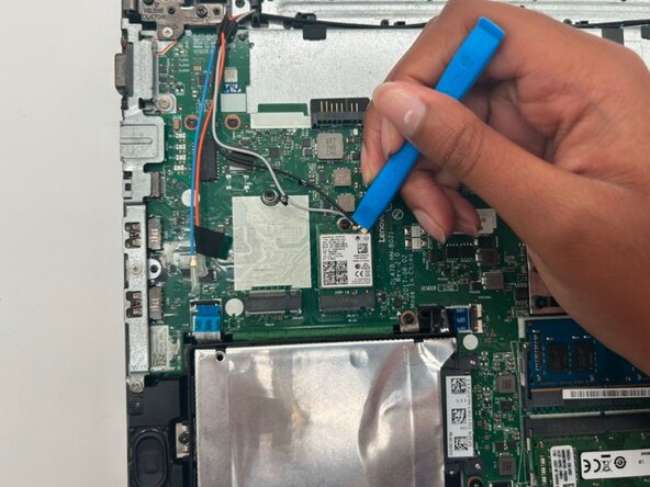

    2. Lenovo ThinkPad L470 Wi-Fi Card Replacement: step 3, image 1 of 3 Lenovo ThinkPad L470 Wi-Fi Card Replacement: step 3, image 2 of 3 Lenovo ThinkPad L470 Wi-Fi Card Replacement: step 3, image 3 of 3
      • Using a plastic opening tool, gently lift the gray and black antenna connectors straight upward to disconnect them.
      • Caution: Avoid bending or pulling on the antenna cables—they are delicate.
      Ask FixBot
    3. Lenovo ThinkPad L470 Wi-Fi Card Replacement: step 4, image 1 of 1
      • Using a Phillips #1 screwdriver, remove the single 1.2 mm screw securing the WLAN card.
      • The card will pop out at a 30° angle.
