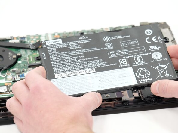

    1. Lenovo ThinkPad L14 Gen 2 Battery Replacement, Battery: step 5, image 1 of 1
      • Remove the three 5 mm screws near the battery using a Phillips #00 screwdriver.
      Ask FixBot

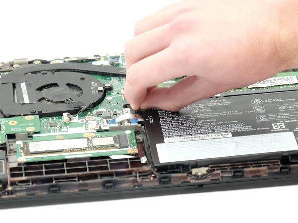

    2. Lenovo ThinkPad L14 Gen 2 Battery Replacement: step 6, image 1 of 1
      • Find the battery cable, and grip the black section, pulling it to the right.
      Ask FixBot
    3. Lenovo ThinkPad L14 Gen 2 Battery Replacement: step 7, image 1 of 2 Lenovo ThinkPad L14 Gen 2 Battery Replacement: step 7, image 2 of 2
      • Hold the battery by the sides and remove it, setting it aside.
